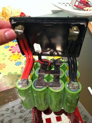

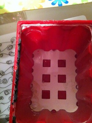

Hi

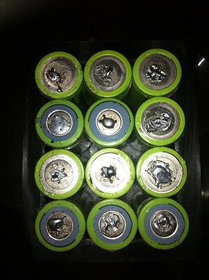

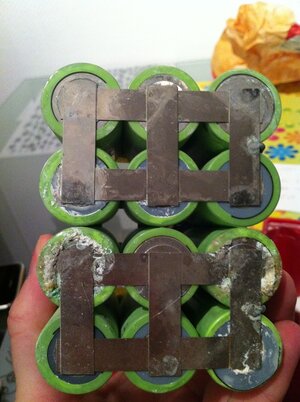

After 2 broken Ballistic, i open one, and look inside.
Very poor Quality!
The Cellst are ok, but the work on them suxx.
Case is not waterproof, Cells connection is
too.

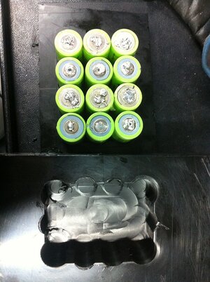

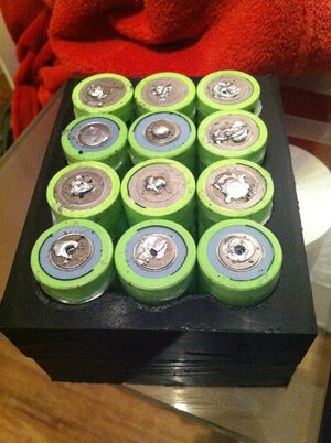

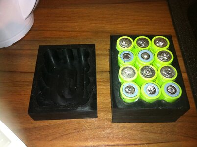

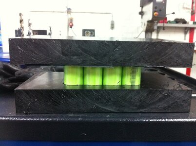

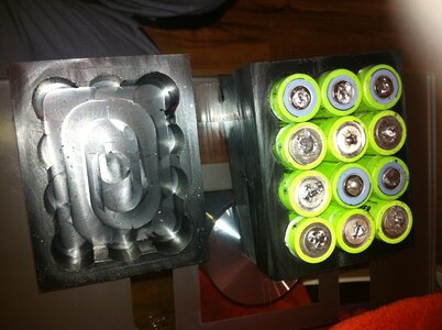

I try to build a new Case, thats nearly the same then ballistic. But i build a case that i can open so change broken cells, what can happen sometimes.
Just started today with some work.
50 % done
Maybe somebody got some good ideas how to seal the 3 parts.

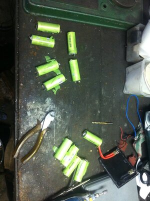

I bought original A123 cells, and iam going to solder them tomorrow
