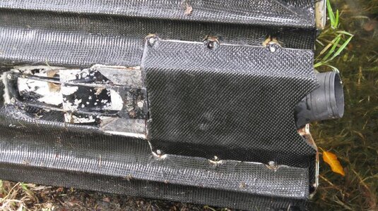

that's because it's textured. textured surfaces don't stick to water as well as smooth ones.
Yea, Ive had that in my mind the entire time, I just didnt think that it would make that big of a difference, not for just the rideplate at least.
