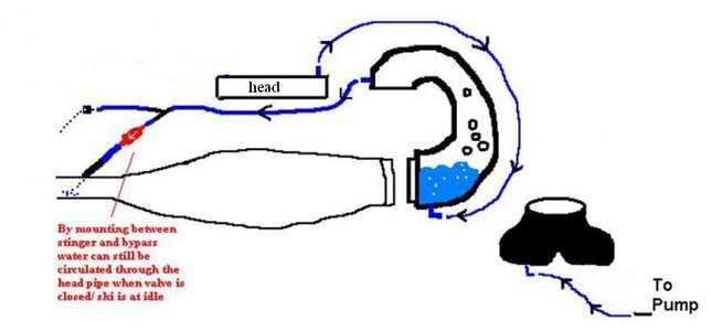

the only problem with the jetworks valve like that, is it is easier for the water to bypass than to ever OPEN the valve and get in the waterbox, unless its adjuster very loosely.
I think ive got 3 shims/washers in mine, and it opens whenever I pull the trigger.
