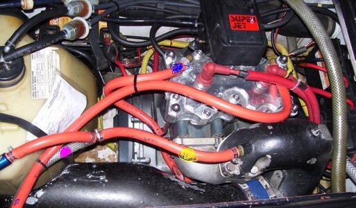

here is a pic of mine, this is BEFORE I moved the jetworks valve right after the headpipe...
yellow squiggly is where the valve is now.
purple squiggly is the stinger line that has the restricor in it.
blue sqiggly is a restrictor out of pipe into head, to increase water pressure in pipe to make the headpipe screws more responsive to adjustments.. this was the part I was missing all along that made the MOST difference in my particular setup.
it might blow to hell tomorrow, it may be incorrect, but after reading 2,986 posts here, and asking lots of people lots of questions, this is the setup that I finally got to work and make decent power.
