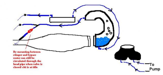

Shonuff
I've got the glow
Memphis
Thanks to freestyleriverrat
Ericfox
Do it twice?That's DooDoo
if you're going to do single cooling then just set it up like factory pipe says in the instructions... like I said in the PM- dont worry about the pipe rubbing.... unless it is really pushing hard on the hull, but it doesnt sound like it from what you describe... sounds like you're almost there!!!!
