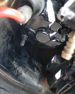

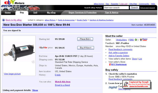

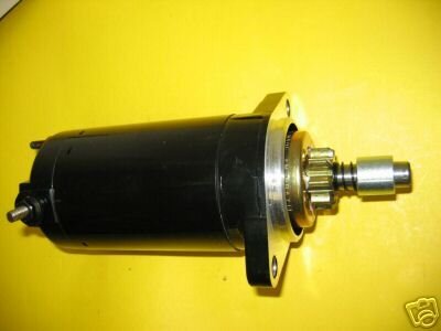

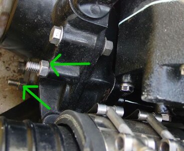

this is a super easy mod and it makes the 550 way easier to start. look for any starter out of a 1989-1994 sea-doo. I bought a new one from ebay for 100 bucks. only thing you need to do it find some longer bolts (see pictures) they need to be about and inch or so longer than the bolts for the 550 starter. the seadoo starter is skinnier and it has not bolt in the back that attaches it to the crank case other than that the fit is the same. once you do this you will never go back.
