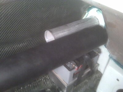

not a bad idea but its not easy as you make it sound. going through foam its going to be a bigger pain. but i might end up doing that. better then getting another trim.Install a trim tube where you need it. Drill a hole the diameter of the pipe you use. Cut some teeth on a pipe and use it to cut through the foam. Install a new pipe and 5200 it in on both sides.

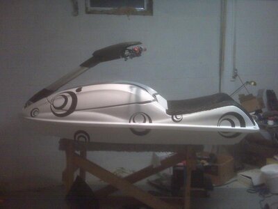

dont have one yet. looking at a few setups. ive seen what you've got.Cool, distinctive graphics. What engine are putting in it?:deal:
not sure what length those bars are but they all the way maxed out. i want to say they were meant for a SJ set up. they will be shorter than im used to but kind of glad to have to go shorter and learn a shorter and stiffer pole set up.looks good, What is the length of your pole? Looks really short.
