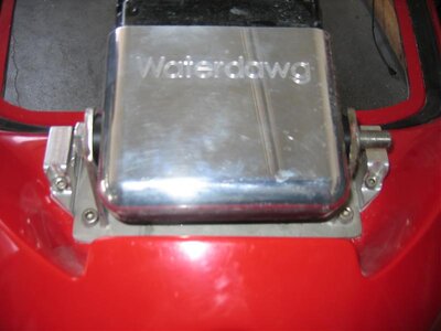

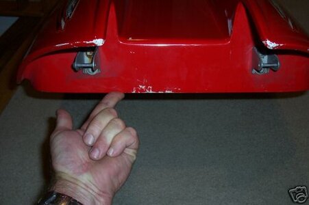

You all must be referring to the "updated" octane hood hook design, cause the original setup on my '02 was worthless. The hood would pop off even if the latch stayed closed!!! :11: They came up with the new style for '03 & up I think....
yes i just spoke with corey and he is gonna put up a pic.his are the only ones i have ever seen.he said they are an updated version from watcon

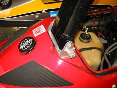

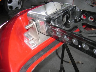

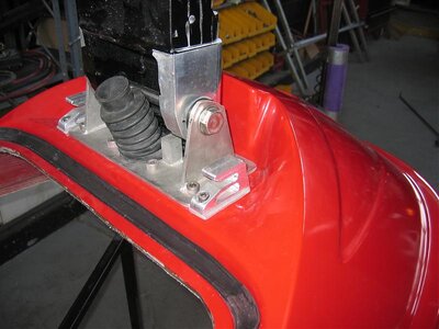

I'm going with the amw superjet bracket, I think the superjet setup works fine, and I'll run a strap. I like to run my pole real tight with a spring and billet brackets dont work that well because the ears dont bend in a little. Still waiting on glue, parts from jeff and bottom deck is at the paint shop

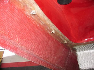

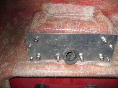

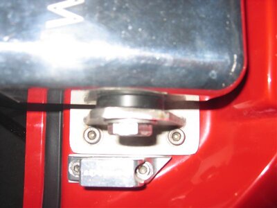

while I was waiting on parts from WDK, Chad and I fabbed up a hood latch system using some modifed wdk hooks We had to space them up a bit to make the hood fit nice. Backing plate was made also.

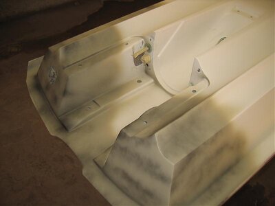

We flipped the upper deck over and reinforced the hoodseal area and bracket area. Octanes are really thick here but I usually have problem in these areas so it got a layer of biaxial. Its so easy to reinforce when the top deck is seperate.

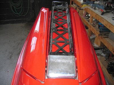

Pole is back from the powder coater, there's a red skin that goes over the top of it.

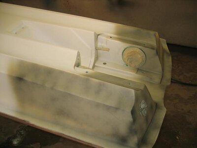

scallops finally ready for paint
