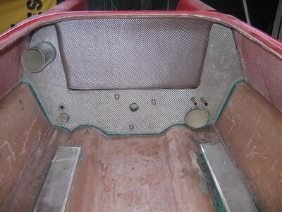

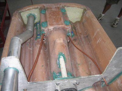

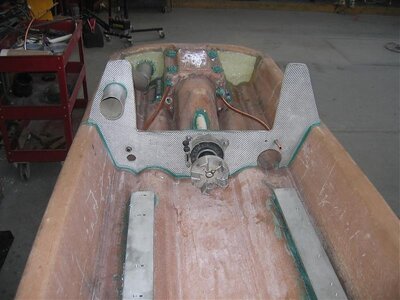

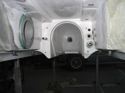

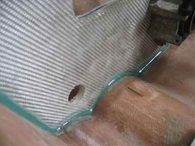

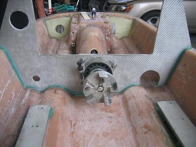

more progress the last couple of days. I decided the bulkhead needed to be thicker since i wasn't using the back part of the waterdawg part. Bulkhead is covered in texilium and glued in place. We also glued in alot of the inserts and aluminum exhaust. I ended up having to move the steering cable up to get it to work with the tilt nozzle without binding anywhere. We plan on finishing the plumbing of the back end tomorrow and start laying glass over the aluminum motor plates.

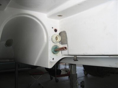

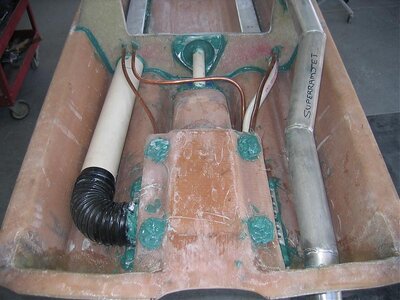

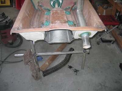

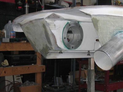

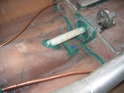

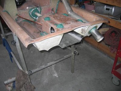

We got all the rear plumbing done today. Steering cable has been moved up to better work with the tilt nozzle. Tube for the trim cable is directly above steering cable tube off to the side so they can be run down the side of the ski. Both cooling lines exit on the manifold side. 3 inch xft scupper. All inserts have been sealed and Every thing has been glued on both sides to keep the foam dry.

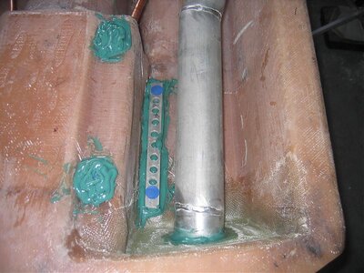

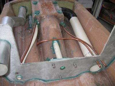

we also laid some texilium on the upper part of the hull now, because we thought it would be easier than when its glued together. We had to set the top deck on to see what it would look like.
