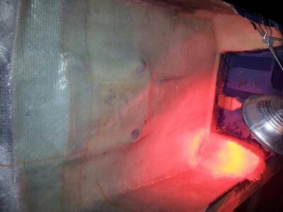

IMO it is very worth it. I love wide trays. It makes the ski much more sensitive to body input. It allowed me to use my feet a lot more to help steer the ski. It also helped with balancing. I widened the tray on my SN and my backie chan I now ride has a wide tray and its great. It feels weird to ride a stock hull now. I had cut my tray out and packed it with pink foam. I then used 2 part foam to get the shape I wanted and glassed over it to desired strength. It was fairly easy compared to building the nose and pole bracket area on my ski.

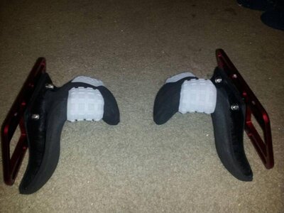

Waited months for these hard to get puppies

Nice! Wish those were in my budget. I need holds that lock me in good.. But I'll probably have to make my own, something that's not adjustable though. I don't think that'll be too hard since it's just off of the tray walls.

Over 200+ isn't realistic right now for holds. I'm thinking I'll make some decent holds that are ledges off of the tray walls. I've got an idea in mind now :) just gotta find the right height so I can add 25mm/25mm pad and be locked in tight.

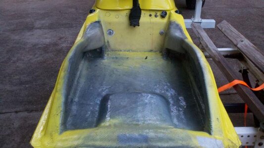

Those don't work with a super wide tray, that's my point. I've got his oldstyle holds in my ski right now, and I've got another awesome set I was going to put in, still might, unless I endup making a wide tray. With a wide tray your foothold options are limited.
I like my wide try and home grown adjustable foot holds. The RRP's are real narrow if you don't widen the tray.
