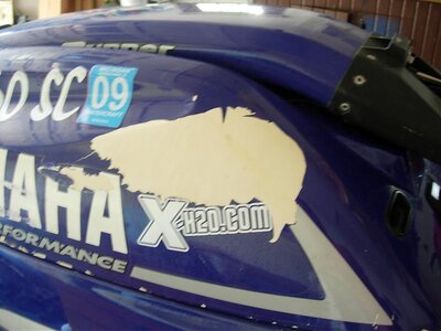

I ripped off an 8 inch by 8 inch chunk of paint last weekend doing subs. I need to get some paint. I would prefer something that I can get in a rattle can but I have a cheapo paint gun I can use if I have to.

Buy spare blue RN hood for under $100. You'll never make it look good with a rattle can.
How do you rip off paint doing subs? Especially 8 x 8"? Its not OEM paint I'm guessing...

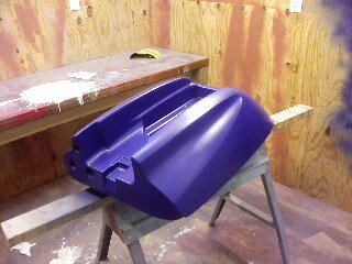

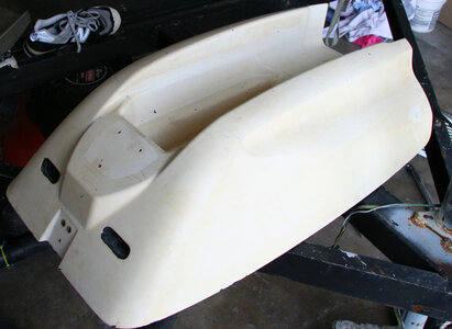

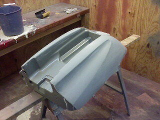

I got all the old paint of. Most of it peeled right off with the use of a heat gun. I bought new paint last night. I spent about a 100 bucks on everything but I am sure I will have some left over. The plan is to get it primered tonight. Color should be laid on friday and clear it on sat.

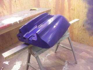

I finished the clear last night. The paint looks a little purple right now but I think it might be the uv type lights in the paint booth. I ended up with a few specs of lint/dirt and one run. I am not that worried about it though. It will be a good spot for an X sticker. I took a few phone pics I will get them uploaded.

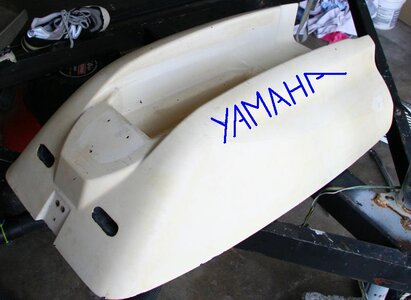

Yes its OEM paint. It comes off because Yamaha never preps the SMC after it pops out of the mold. It still has the mold release and they just paint it to save time and money.
So after a few years(or less) it starts to peel and that is why it is so easy just to scrape it off with a razor blade. Its a very poor bond and YAM dont care because by the time it starts to peel, your warranty is usually expired.
If they would just scuff it before they paint, I bet it would hold up a long time. I did the hood on a Blaster 1 awhile back and razor bladed off the old red and prepped it and painted it black and it hasnt peeled or done anything funky(according to the guy i sold it too).
