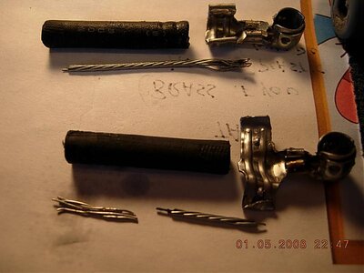

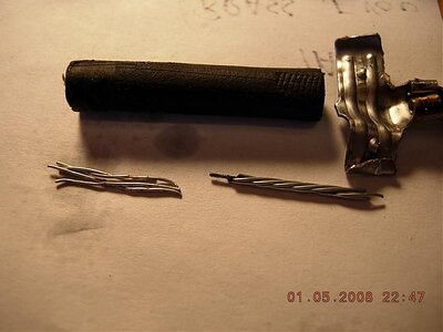

I split the wire ends open and I'm sure I found the problem. The top wire came out in one piece and looked fine. The bottom wire was completelly seperated in two parts. If I would of cut the wire back another 1 1/2" it would of fixed the problem.

Glad you found the problem.
These damn wires always act up when your under a load. Almost imposible to find if you can see the wire and it looks fine to the eyes. Nice job.

According to John @ JSS, when I raised the compression it took more spark than it did with the stock head to fire the plug. Combining that with running it under load in the water the wire just couldn't support the spark. The wire was just too deteriorated to jump the gap so to speak. What made this more confusing is that I cut the wire back 1" but it still wasn't enough.

The Ohm meter is your best friend when chasing electrical problems. You cannot always assume that the wire is only broken an inch or so from the plug caps. I have seen several fail near the Ebox, but only when wiggled while testing with the ohm meter. The biggest failure cause for the stock or any wire is the vibration and wiggle of the wires while running. Personally I run two wire holders on the head to keep the wiggle factor down. So far I have had no problems with my coil running good 18 or 20 strand wire. I wish I had seen that Moroso 8mm wire that Crab is using when I did mine a while back. It looks like it would hold up better than anything I have seen yet.
