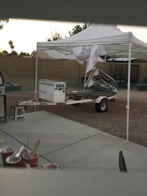

Anywho, the day I picked up the WB1 hull.
As you can see, its ugly and needs the bond line repaired on the nose, but overall solid. Already sourced a clean and solid 701 with good compression out of a VXR PRO I snagged cheap off marketplace. I have a few 650s kicking around in various condition, I'm going to try and piece together a solid running motor and drop that back in the VXR to have as a back up/buddy ski, or will sell cheap to recoup a little cash.

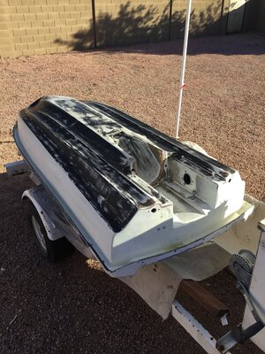

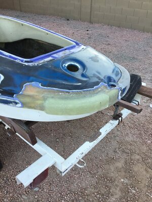

Glass work began this weekend, been a min since I've done this, thankfully I have a good teacher to remind me how its done (thanks Chris @smoofers !).
Had some thin tin metal kicking around, so essentially I made a backing plate wrapped in duct tape for a release to get the initial base going on the nose repair, and it worked very well, 4 layers of 17oz biax to start. Trimmed it up a bit, knocked off the blush, flipped the ski over and laid up the back side with 2 more layers and curing as we speak, will likely add a few more on the front side of it then should be good.
Also deleting the oil level sight hole in the hull, as well as minor repairs here and there, much less work then my square thats for sure! Still, glass work is meditation for me, I enjoy it, very easy/forgiving to work with so it's not a stressful endeavor, just a messy and itchy one.

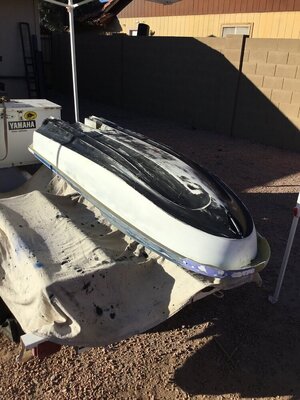

Weekly update, been hustling on this all week after work until its too dark, being driven nuts by the mosquitos, trying to knock out all this body work so I can get it in my shop and start the nice clean assembly work. Anyone looking over my fence will see me and this thing in various odd positions trying to get better angles for lay up and what not lol

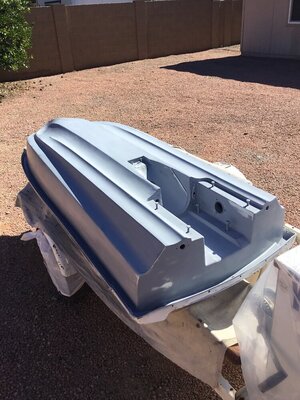

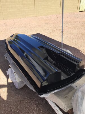

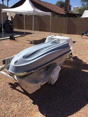

Nose glass work is done, 12 layers of 17 oz biax split front and rear I think is plenty, also added some thickened epoxy inside at the bond line to help as well. Unless I can find or decide to use the factory bumper, plan is to turf the side rails and nose, so while I do need to do a little filler work to get it to where I like, it wont be anywhere near as much work as I did on my square's smooth nose project.
Got the bottom all patched up and painted with appliance epoxy, someone boogered up the pump shoe mounts/area so had to do some repair there, as well as some minor chine repair. Now it sits this way until my pump shoe from @JetManiac shows up, then I can flip it back over and continue the top deck body work. Hoping to have it painted and in my shop by next weekend.
