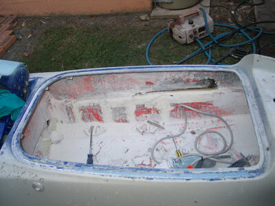

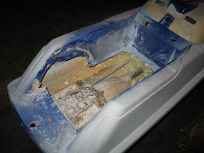

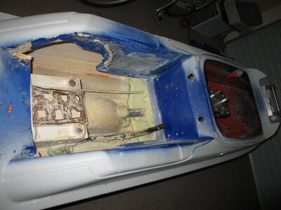

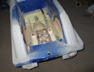

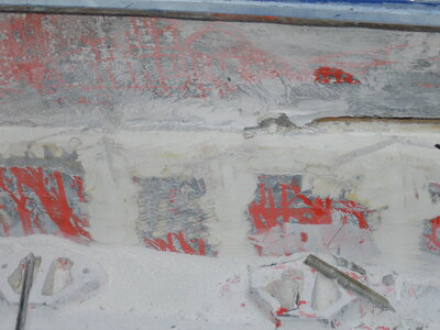

Put the ski on it's side and then mix some 2 part epoxy with some milled fibers (to thicken it up to a semi paste) and then pour it in the bond line all the way from the rear end ,to the firewall. then add some bi-axial from top to the bottom of the hull. If you gona ride this thing in the surf, make sure you re-foam with some 4 lbs closed cell foam:biggthumpup: Then this hull will be bullet proof and ready for some crazy surf
Keep us posted on the progress, good luck:Banane01:
