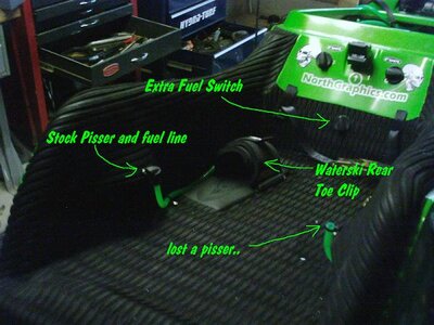

I drilled and tapped my water outlet and attached a 1/8th NPT to 3/8 hose fitting to it. I then ran a length of 3/8th hose to dump the warm water straight down right at the front of the tray. It cascades down and runs out the back. Kept my feet toasty warm today in 60 degree water.
I read about the tip somewhere here, so whoever you are: THANKS!!
