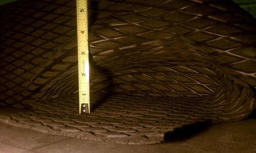

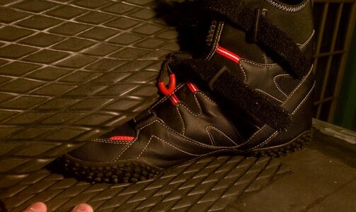

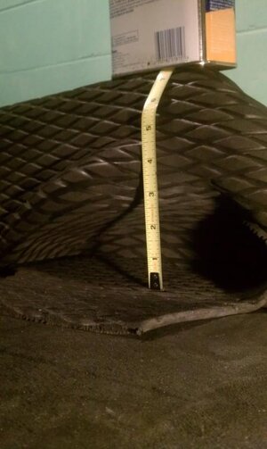

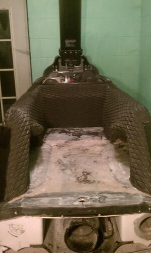

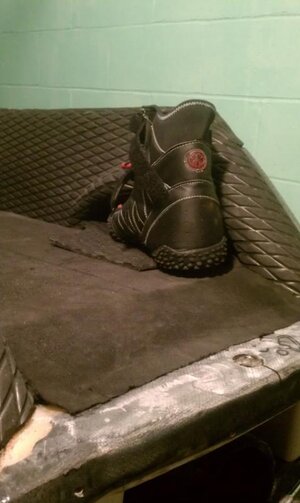

I was checking the clearance of my tom21 footholds with the 1 inch pad. It almost seems like it is too tight (ankle breakers). If this is normally how tight they fit, how easy do your feet come out during a wreck? I am thinking about trimming the pad down, or using two layers of 8 mm. Let me know how you like the fit of yours (mainly how easy your feet come out of the foothold). ThanksIMAG1235.jpgIMAG1233.jpgIMAG1236.jpgIMAG1237.jpgIMAG1239.jpg

The 25mm pad will squish down over time. I've put extra turf on the instep area to compensate. I wouldn't trim.
What he said, they are designed by tom for the 25mm pad. I have added extra pad on top also to make them nice and tight. If you fall you come right out.

thanks for the advice. I understand tom made them for the 1 inch pad but i have 3 layers of fiberglass on the bottom and plenty of resin. I was worried that I had built it up too much. I will just use the full 1 inch pad unless someone suggest otherwise. Thanks guys!

BTW: I love my tom21 holds. I love 25mm pad. They will loosen over time, as said. You will find ways to tighten them up until a re-turf. Until then....enjoy!
