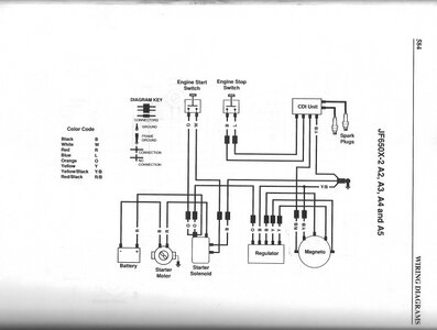

Well the 750 is in, ready to brap, poured some gas into the carbs and fired it up. B R A A A A P P P ! ! ! ! it goes, then I see the smoke, fried wires coming into the ebox,
:banghead: :banghead: :banghead: .
Oh and a special thanks to Matt_E for the wiring help last night.:rolleyes:
Important lesson number two. Don't allow people who have been drinking to rewire your ski at 2 AM :rolleyes:
Time to pull the 750 out and do some more work. On the positive side, I'm getting dang good at taking this thing apart and putting it back together.
Hey now....first of all, I had ONE drink all night. Second, we did the wiring far before 2 am.
Third, I am just a hack. Proven again.:frown:
I will get that stator out tomorrow and start rewiring. Sorry man.... I feel awful. :frown:

If you have to go to all that trouble,perhaps just install a 650 electric package, stator, flywheel,front cover, cdi, etc.. Those 750 stators are known for problems anyway, and the 650 has a better timing curve stock. Or just do the 650 motor for now, the ocean is no place for a boat thats not fully tested. You won't need the extra power I assure you, you will spend most of your time trying to stay on the dang thing!

eh, I could've pinched a wire as well. . .
Don't I have to have some stuff machined in order to run 650 electronics? I'm not opposed to just throwing the 650 back in there for the beach ride. 14 foot surf is :bigeyes: :bigeyes:
