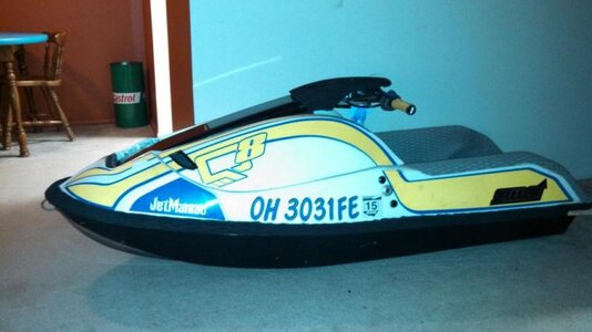

Onto the NEW! I snatched up this hull (EME Q8 Stalker) a while back on some borrowed money and have been slowly been gathering parts to get this together. I have been able to ride a couple of these hulls, even Eric’s 1200, and the handling is fairly close to what my stunt was. What’s cool about these is that any engine and be thrown into these with the correct adapter plates. Because the funds were low I will just be going with a tried and true ported 701 thus relying on just my skills to do the rest.
The breakdown:
62t/61x ported 701cc
ADA girdled head
Lightened stock flywheel
ATP EPIC
stock 38’s
Coldfusion drive coupler
650sx drive shaft
650sx midshaft housing
skat 145mm setback mag pump
9/15 hooker
bpip mod chamber
ATP waterbox
waverunner 3 exhaust hose
550 fuel tank & westcoast pickups
X-metal scupper
X-Metal Adjustable Handpole
X-Metal Adjustable Steering System
Oh and yes I built this in my living room
