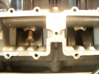

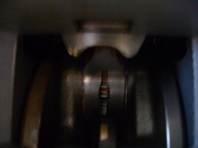

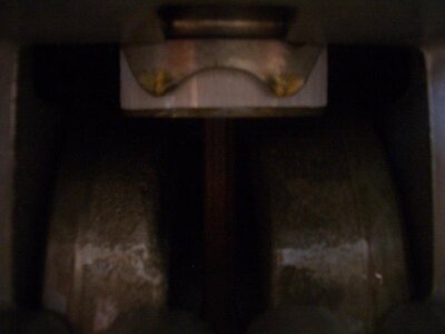

Well I guess that means the reeds are good...
Take a couple of pic's of the engine setup and let me look...How do you have the cooling lines run? Is this a stock SN waterbox or a RN aluminum box?
What impeller do you have?
Is this setup with a MSD Enhancer?
I have to think that the Pop off is too low...back to 1.5 and the stock 115 gram spring and a 80 low and the stock 130 high.
I got the motor out and the exhaust mani off right now but I did not remove the cylinders yet. I looked the pipe over and didnt have any leaks that I had found. I has a RN aluminum waterbox and the outlet of the waterbox comes out and up to a front outlet on the left side. It has a 10-18 prop on it. For the CDI it is a protec one.
I will try it again with the carb setup that way but I had it setup like that in the first place with the pop off at 55 psi and 70 low and 135 high so I will try to run the setup that your saying.
