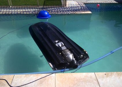

For some reason these pics wont render in my build thread so here they are as seperate thread

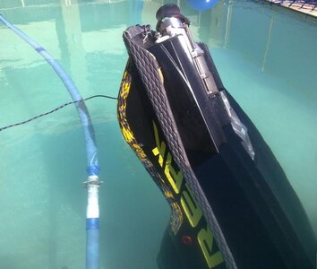

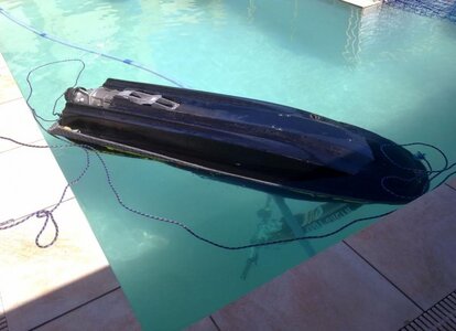

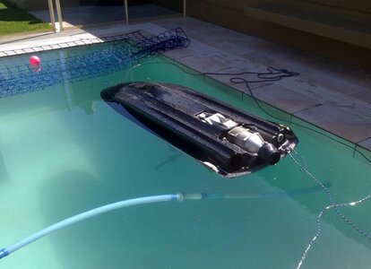

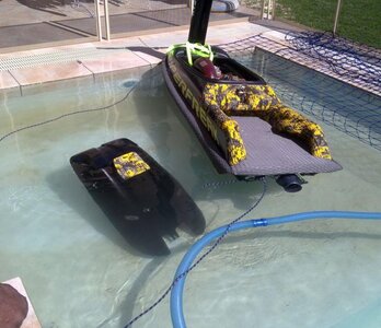

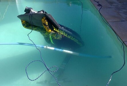

She floats really, really well.. hood removed and rolled upside down....fully loaded, riva pipe, heavy battery, no fuel tank and 6 kgs of extra weight (just because) She stayed inverted for about 15 minutes by which time I then had to turn her over a number of times to get all the trapped air out ....last picture she was at that level for about another 30 minutes.
FLOATS extremely well......had out and drained a teaspoon of water from the left drain....great job TEM !!!!

Well it is interesting that the scupper did not let air out like many think would happen. My freak has been tossed around in the surf like a rag doll and no water problem after being upside down for awhile before someone towed me back to the ski. Not only didnt sink but started right up.
I should have mentioned that I blocked the scupper off both sides with removeable threaded plastic caps...air trapped in the pipe=more bouyancy....scuppers a bad idea in the surf. way too many go bad at the worst of times.....i have two bilges.......in addition the front foothold is attached as a unit, It is carbon kevlar over molded poystyrene.....and I have SN foam in the front....call me OCD.

Andre , Thanks for the sink test, I still think it's a good idea to add nose foam or a float bag on the Superfreak Bad Ass in big surf like you will have in South Africa .
Hi Tem......def. agreed....I already have two inflatable air bladders which are used by the white water river rowing guys ....will find a place to stick them and inflate before I ride. The motor was a blown one with not much I can use on it, so it came in handy for the test.
The thing that amazed me was that the xmetal pole, which is heavy, made the ski float upside down in a very stable way......which then traps a hell of a lot of air in the engine compartment, which can only escape via the scupper if you have one, or via the bilge outlets, but only when the ski is then pulled onto its side.
hey sportfish........well spotted........you made a great part right there !!!!!!,. great job..... I dont think the hood will ever come off, unless the brap strap gets loose somehow.....( I read that somewhere on the X. it happened.....my overriding fear though is in a worst case scenario is getting seperated from the ski in big surf, and its upside down and getting flipped repeatedly by incoming rollers.....how long before the nose drops and down she goes.......well now I know for sure........wont happen !
