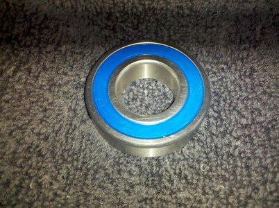

Is there any benefit to running stainless bearings over standard bearings in UMI steering setups? Did they originally come with stainless bearings?
I can buy a sleeve of 10 standard bearings for the price of 2 stainless ones.
The o rings don't last forever! I always make sure that the threads are degreased and install the lock nut with red threadlocker. I get a few years of use out of that and then just change the internals. Hot Products sells a kit cheaply. I would not bother with ss bearings.
for steering i use SS shielded both sides, pretty sure part numbers ending ZZ. Pump just SS with no shield. You can also get plastic shielded as well but none are "sealed"

I just ordered enough to put together 10 kits complete with stainless bearings, o-rings, stainless radial washers and locking collars.

My HX has a UMI steering setup on it. I threw in the Hot Products bearing kit (same as the stand up bearings) and they rusted within a few rides. I keep them lubed up but it really annoys the hell out of me that every time I ride there is black rusty drips on my cylinder head. Ugh...
I would love stainless bearings...
OCD would you consider just selling me the 2 bearings?
just make sure to use good waterproof grease in the bearing cap cause if that ss bearing reacts with the alloy cap you'll never get it out.
