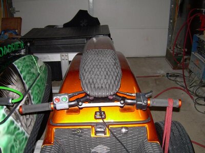

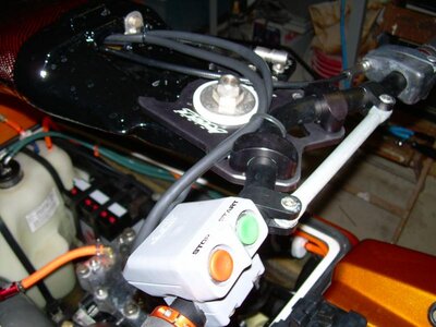

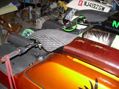

Finally got around to making a handlepole pad for this ski. I'm getting tired of the corrosion at the mounting bolts that comes from all the dissimilar metals of the stock pad (bronze nuts, stainless bolts, aluminum pole casting), so I mounted this one using aluminum brackets riveted and epoxied to the pad and then used GM style panel fasteners (blast plastic barbed thingies) to mount it........we'll see how they work, I think they be fine.
