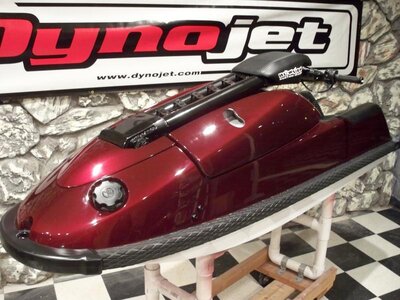

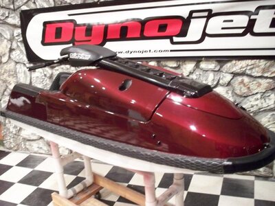

Hello everyone! Been some time since i've posted so I thaught I mite post up my long and awaiting ski build! So give her a look and tell me what you think!
~Matty@ski-innovations.com
-2002 Yama rn hull
-painted cherry candy apple red along with new base clear underneath
-footholds
-Wdk Razr hood & nose cone, thanks Jeff @ Waterdawg Customz!

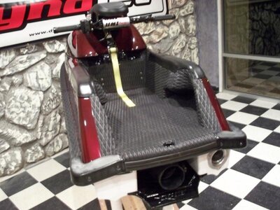

-black hydro turfed tray and sides
-4 black 45 degree pissers controlled by 2 seperate control valves 2 on each side of hull along with 2 black bow eyes
-black diamond plate fuel knob and primer backing plate with duel black bilge outlets
-made my own hood strap setup

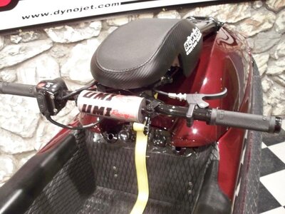

-fabed up a beefy lowered hp bracket and 2" shortened handle pole with 0 degree umi bars and a umi turn plate sealed bearing combo
-ODI ruffians
-handle pole bar mounted bilge switch
-Blowsion chin pad

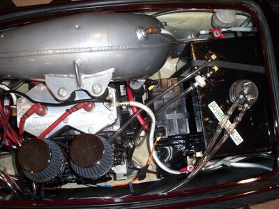

-duel cooled 701 recent rebuild
-Riva 4 dry pipe and exhaust mani. 28 cc domes, with riva head
-v force reeds
-short k&n filters
-MSD inhancer
-clear lines throughout
-duel Rule bilge pumps on custom bracket
-fabed up a fuel cell with fuel level guage and central mounted battery tray for less weight, stronger, and more ergonomics
-Pro Tec ride plate and Riva intake grate
-Impros Hooker, Thanks Dave @ Impros!
P.S. ski is up for grabs P.M. me for further details.
