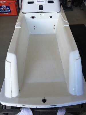

Your engine bay is super clean
What kind of bilge are you running ? If it's a working siphon system and your getting 3in water that's a lot of water.

Thanks for the compliment on the hull. I keep my stuff really clean. It's a lot easier for me to see problems and fix issues.

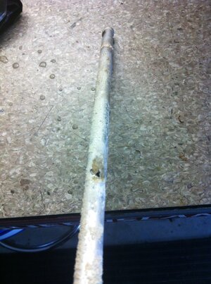

Yep that was me. Some water did drain out but not a lot. I had the same symptoms as you. My engine bay was filling up fast during riding. My cooling tube was corroded out inside the tray pumping the tray full and overflowing into the engine bay around the exhaust. I'm currently doing footholds install so I cut open the tray to refoam it anyway. After a week of draining it the bottom 3 inches of foam was still waterlogged and there was still probably 2 litres of water swishing around in there after I got the foam out. There's only one way to fix it unfortunately and it involves fibreglass and itchy arms for a couple of days.
