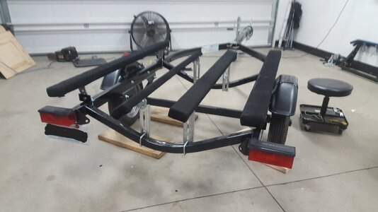

I just picked up a brand new shorelander single couch trailer and have added addition bunk supports for both my skis. My friend is currently fabricating custom double mounts to hold bow stops to safely hold a Rickter and SJ.
the picture is during mock up befoe they were adjusted
Get the grinder out!
