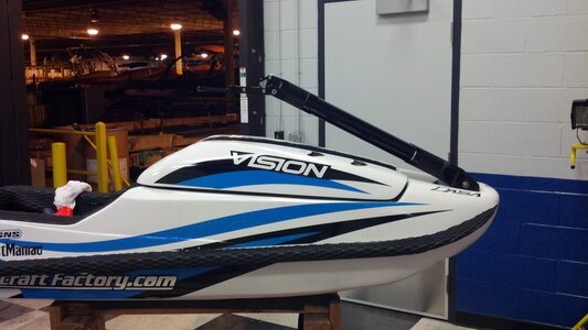

Ignition mounts also in.
I picked up a BOB billet pole bracket to use with a Titan pole. The base of the bracket was just a little too wide so back to the mill for about and 1/8" off each side.
During assembly of the Titan pole I had to take a drill to one of the holes between the upper tube clamp and the top plate for the steering. The side braces were machined slightly different on each side and caused the angles to be just a touch off and not line up. Not a big deal, but I'm disclosing any imperfections I encounter on the build, especially on brand new parts. That is stupid I would have to put a drill to a pole the retails at what? like $1200
I decided to run a pole spring on this ski. Last few skis I've always ran my WDK pole tight without a spring. So a blowsion spring was picked up to use on this build. The combination of the BOB bracket and this pole was not plug and play with the spring. I torched it and reshaped the spring was able to get it to work. I'm glad I want through the effort to get it installed.
