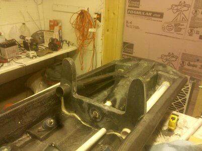

I had to add some reinforcements to the pump tunnel. I was going to start running cooling lines and noticed it was real thin in a few areas.

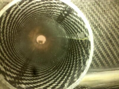

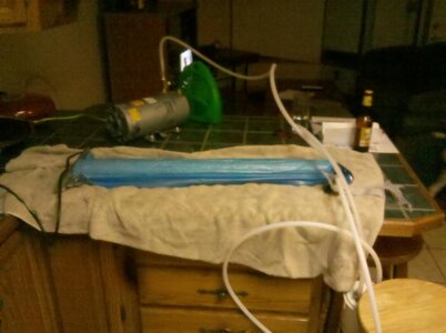

Attempted to make some carbon tubes for exhaust. First tube I tried vacuum bagging and it ended up creasing the carbon. Looks ugly but is still strong as crap. I sanded the ends and wrapped another layer of material around, followed by peel-ply and then electrical tape. This worked out well and left a nice finish.
The second tube I laid up turn out better, but still not totally smooth on the outside. I used 2" PWC for a plug, waxed it with some mould release and found if I put it in the freezer after the resin had cured it slides right out. I will try to use this piece in place of the long rubber exhaust hose.

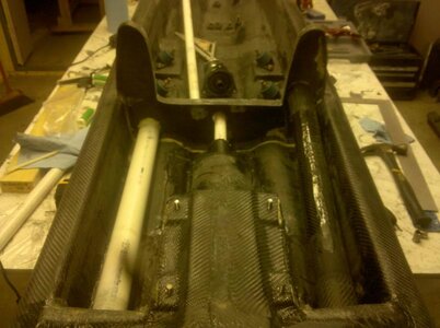

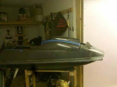

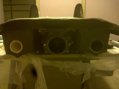

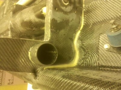

Got the through hull tube installed, pvc pipe for versiplug, and pvc for drive shaft. Also spent a fair amount of time fitting the top deck and mocking up some cut lines for the hood.
