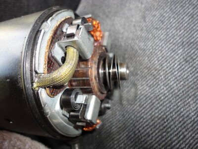

Starters are not overly complicated as you will see from the pictures. They are not something to be afraid of. The only really complicated part is getting the brushes back in, as this job takes 5 hands and there is a lot of spring tension. If you are not a patient person, this might not work out for you...

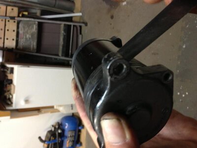

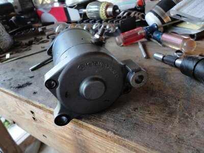

The starter is opened simply. Remove the 2 long bolts and then the end caps. It is important to be careful during this process! The part connected to the positive terminal (brush holder assembly) can get stuck to the inside of the rear cap. Do not force it out, you will break the positive pieces. It is easiest to remove the front cap 1st, then remove the armature (big shaft in the middle), then the rear cap. Don't loos you washers, there are about 7 of them, 3-4 on the back side that will get stuck in the end cap or inside the housing.

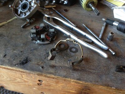

Here is a picture of the broken positive assembly.

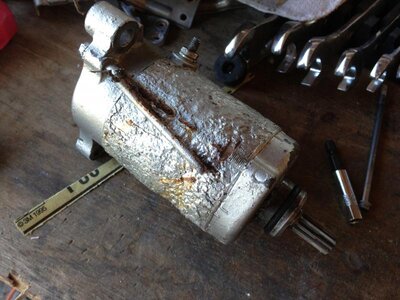

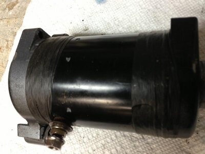

Naturally, you need replacement parts. Well, here's a picture of my old starter. Rough shape I know. I used a 4" grinder with a fiber blade to cut the bolts off. I beat the end caps with a hammer to get them off. VERY IMPORTANT! Remember what I said about breaking the positive brush assembly? Well, my old starter was swollen so bad I could not get the bush assembly out of the rear end cap, so I had to cut the sides of the end cap to get enough flex for the brush assembly to come out undamaged.

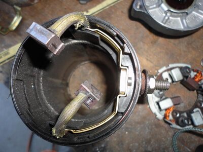

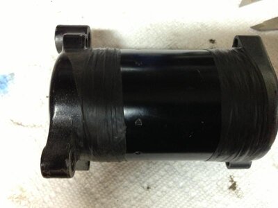

Here is a picture of the part we are after. While my housing is completely shot, there are still usable pieces inside. This piece is a big one. The brush assembly, the armature, all of these parts can be saved to be put into a good fresh water housing with a bad armature or brushes.

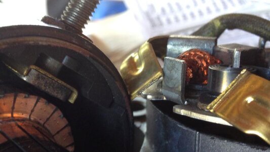

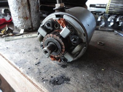

This is the part that absolutely sucks. There is no great trick I know of for this. It is just a fight. The brush assembly faces out from the housing like shown. The two brushes from the positive assembly fit through the small gaps in the brush assembly plate. The brushes have a curved side and a side with a notch. The notched side goes toward the spring, and the curved side goes toward the armature. This is challenging, and I am sure people who build these all day long have a special tool to hold the spring, something we do not have. I was able to get the armature back in by holding all the brushes in with my index finger, then sliding the armature in to the shaft, then to the short raised part, and finally sliding the armature in all of the way to the correct position. If you can get this done, you successfully completed the hardest part of this job.
Here is a picture of the armature and the brush assembly assembled. Don't worry, the armature wont fall out because of the magnets in the housing.

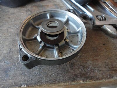

Next, put together the front cover on. It has pieces in it that do not come out for the bearings, so we need not worry about them. 1st is the shaped washer with the teeth, teeth facing the cover, then the fiber washer, then metal washers as shown.
