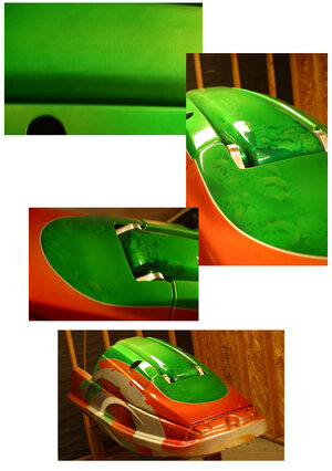

square hood, round bracket, and round pole.
I DID eventually grind into the pole end enough that you could see the square holes.
but that wasnt neccesary, I mounted my hood straps UNDER the rubber bumper pad, raising it, and I should have just removed the rubber bumper pad.
it would work FINE without the rubber bumper there, and the pole ground off a bit.
yes it is a BIT FX1 ish.
its all about the fashion right?
:biggthumpup:

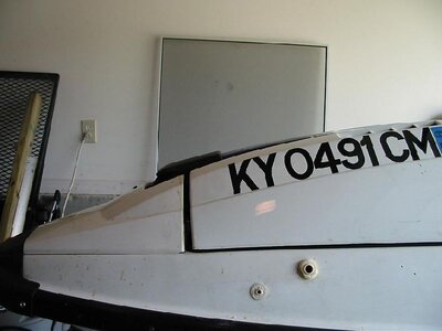

Here's a side shot of mine with the round bracket and pole. I don't have the plastic end piece on there or it would stick up higher. I moved the hood hooks out because the round pole will hit them if you try to use the square bracket.

I was in a hurry to get it back together, so I didn't make a template. I put the round bracket as far forward as I could. If you put it farther back the pole would sit flush with the square hood. The hood hooks location on the bracket will be a little different for everybody depending on where you put them on the hood.
