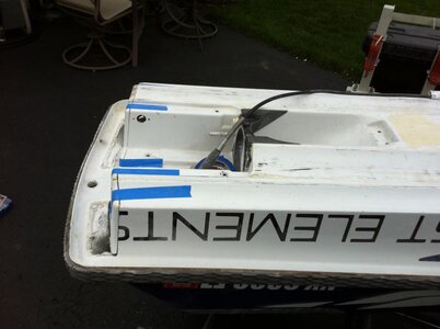

Well I wasn't really planning on building a ski, i was planning on building an 850 PV motor for my existing black 05 SJ. Went to help a buddy buy a hull to do his build and came home with my own. Thanks Aaron for a super clean hull to start with. This is a 2000 RN hull, they are thicker than the newer style and this is one thing i was looking for with my next RN build. Bought it and got delayed building another boat for Eric, the old Pinky III. That took a lot of effort in the spring so I never really got started on this till mid summer.
This wasnt really a planned build as I had hoped to build an aftermarket hull this year, but things have a way of working them selves out. I had been buying all new parts for my new build, whenever it happened and when this super clean hull just happened to be sitting next to me, I bought it. I still love the way a SJ handles and a -2" is about the only lenght to cut a stocker and still have it handle well in the rough/chop conditions we get on the great lakes. I would like this to double as a semi flat water /surf boat but we will see how it rides later.

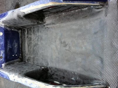

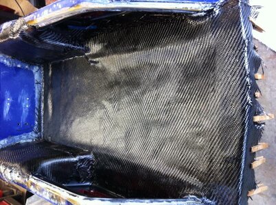

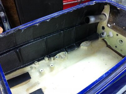

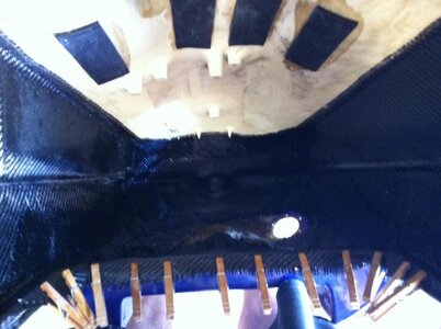

carbon reinforcment for weight reduction and strength

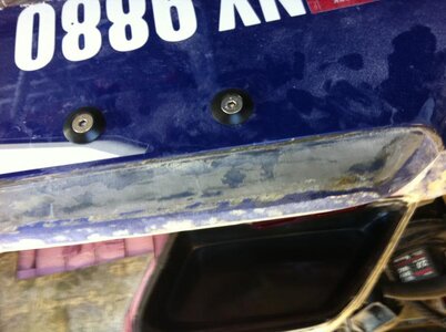

Custom 1" forward and 1" down SS pole mount, back flip mount

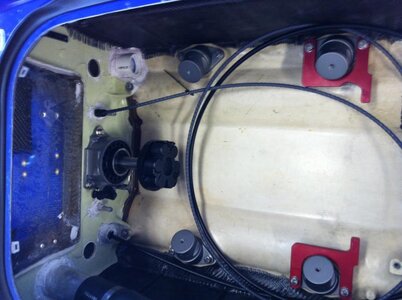

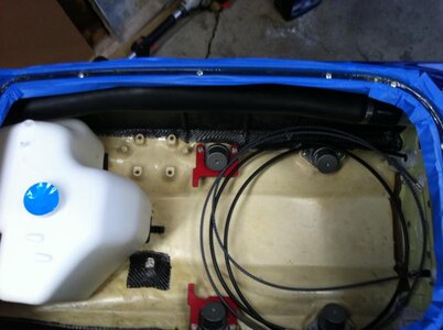

Cold Fusion silver motor mounts Fast Elements
ATP red engine keepers, I know thay arent required with mounts Canadian Freestyle

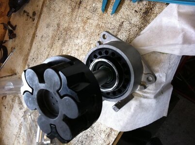

Cold Fusion coupler kit Fast Elements

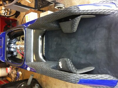

Hydroturf Black Diamond, I have done too many boats lately and the turf is all falling off. Black or grey molded last the longest.
500 GPH rule bilge

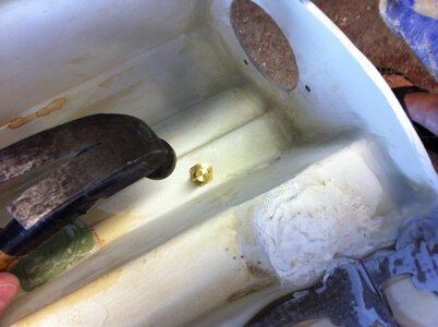

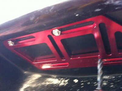

Blowsion billet Scupper flange with my own scupper

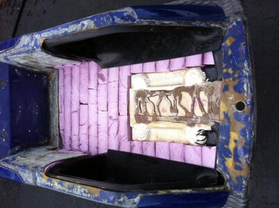

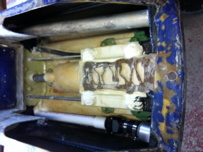

Pink Styrofoam in tray for floatation
Carbon Tray, weight reduction

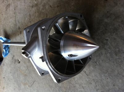

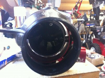

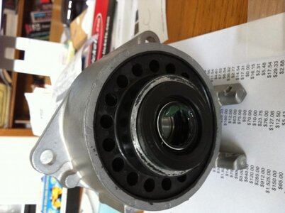

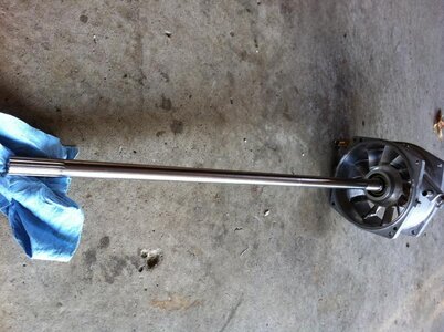

Skat trak 144mm Mag pump 2" set back with 9/15 Impeller, new HD driveshaft Fast Elements

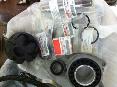

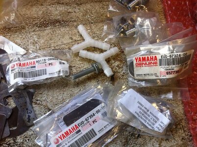

All new yamaha hardware, entire midshaft, gas tank, shims, straps, exh hoses, cables wiring, Start/Stop, etc, etc. I blew way too much cash doing it this way, but I know its good

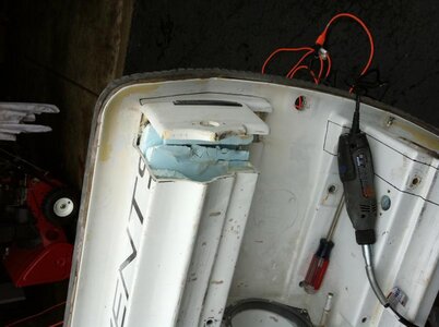

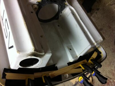

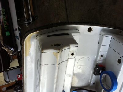

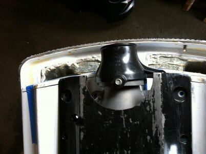

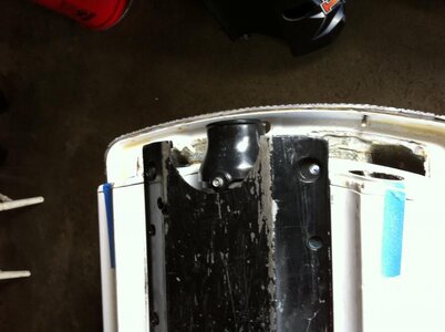

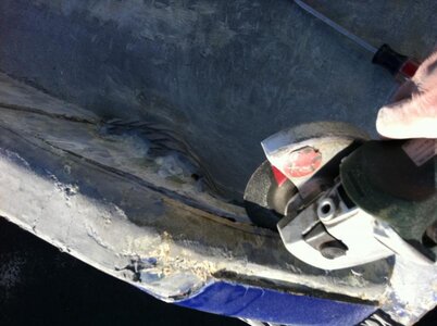

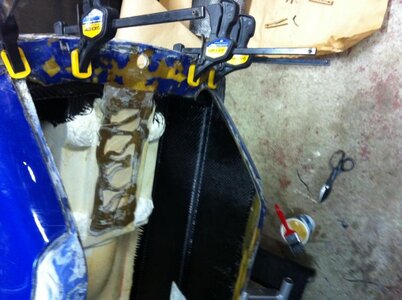

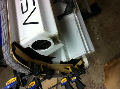

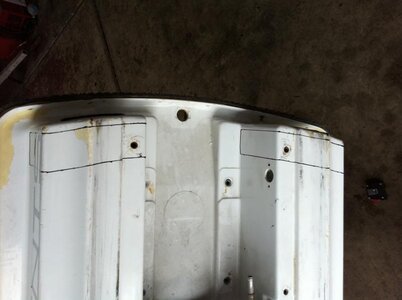

Finally got to making the marks and cutting it up for the -2"
