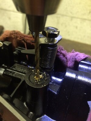

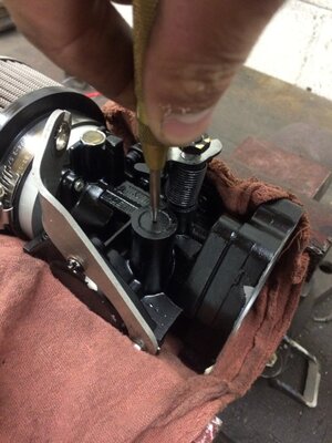

Center punched (optional) I guess

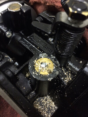

Drill a small pilot hole.

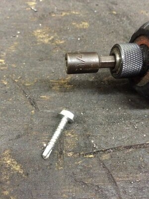

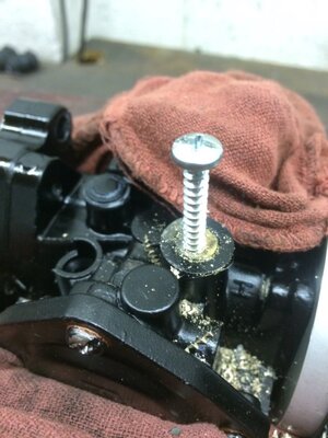

Using a regular pointed screw, not a self tapping.. Self tapping screws will begin to cut the adjustment screw.

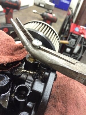

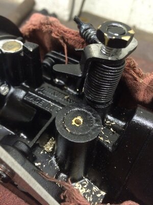

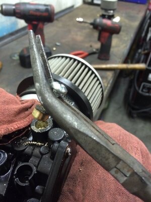

I had my carbs in a vise which made the next part easier.. I used bent tip needle nose pliers to leverage them out.
Now I wish I can say they all went that easy.. But I had one that the screw broke and I had to drill it a few more times. Also they are about 1/4" thick.. Keep that in mind when drilling.. I was expecting 1/8" and got nervous as it kept pushing through. Don't wanna go too deep or else you may mess the screws up and have a hard time removing them.

You made that way hard on yourself. Use a drill bit the size of the plug (I want to say a 3/8 bit but don't hold me to that) and drill out the cap. Most of the time once the bit grabs it spins the cap right out. If not just drill all the way through it. Takes about 30 seconds per cap.
Yea I had just read to put a screw in it and they would come right out. Not the case but it worked, most of them took under a min each, but that one, took a couple extra haha.
