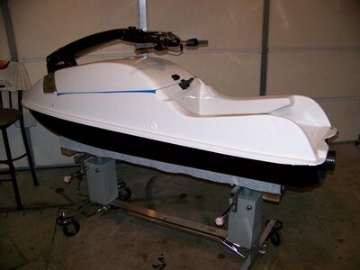

I know this is alot of work but you made it look easy.
It is easy! Just have to have the want to! If I can do it out of my small tool box any one can do it.

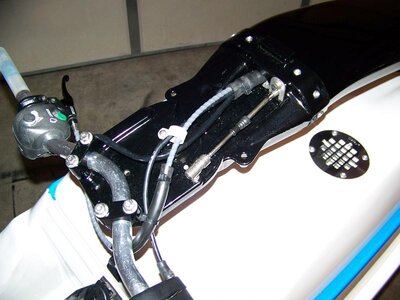

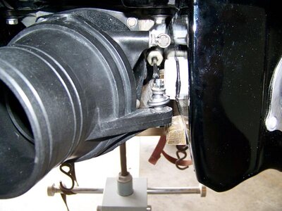

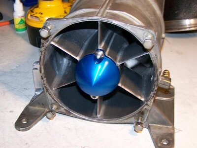

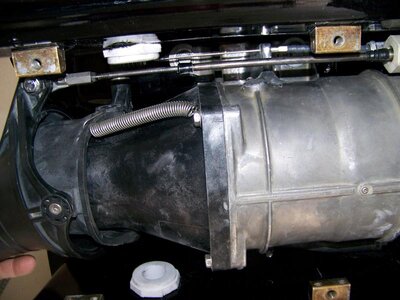

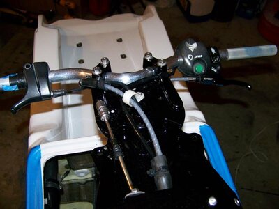

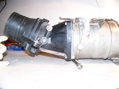

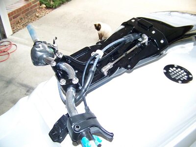

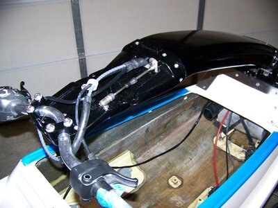

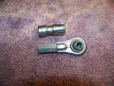

My steering didn't center up with the trim. After a few PM's I learned that you will need a SeaDoo ball joint connecter on the pump end of the cable.The stock Yami one is 3/8 to 1/2'" short. So add it to your list of things you will need on your 650 pump mod if you want trim!

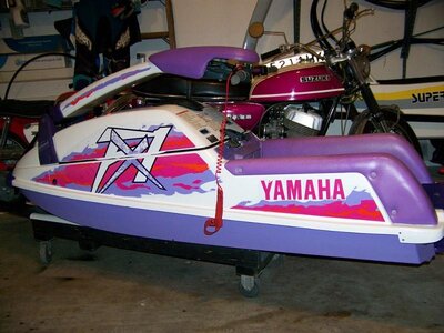

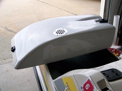

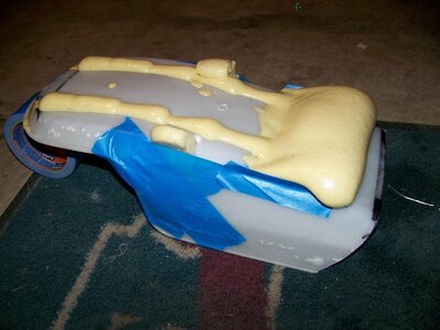

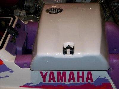

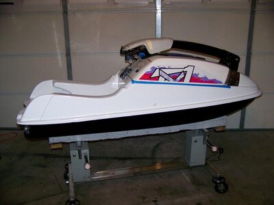

I'm thinking the stock hood may look better?

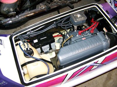

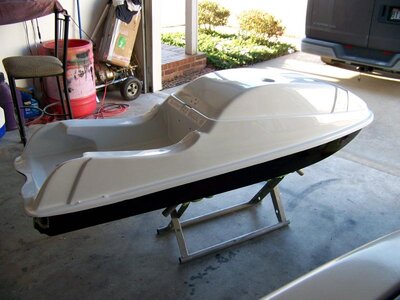

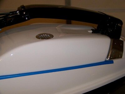

I washed/cleaned out the inside of the hull and filled it up with water just to see the one-way's work. Dang! It dumps the water FAST! Hope they don't have a leaking problem. I will do my best to keep from dropping Zip Ties or anything else in the hull.
