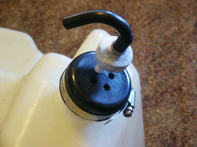

Let me help you here these Superjet guys know nothing about 650SX's,take your stock cap and screw it onto your tank where the pickup is,now you will need to make a new pickup to go into the front of the tank.Also a front carb plate off any SBN mikuni carb makes a nice filler plate for the stock filler hole just add some silicone and use the screws you took out of the plastic neck to hold the plate down.I know you have serious fab skills so this one should be a breeze for you here is a pic of one JSS sells.You can show your appreciation by making me one as well,J/K LOL

That is a nice set up but I like the front just plain old blocked off and leak proof.

Here is a pic of my (I ain't paying JSS no buck twenty) front pickup,its the stock pickup off a 91 or older Seadoo,pick a model they are all the same,you have to cut a piece of hose from the stock setup install it inside the Seadoo setup and press it on,remove the plastic pickup tubes, install stainless ones made from brake likes,add fuel line and fuel clunks and enjoy,use the money you saved to buy beer.

Hell no on the silicone.
I like 2 licks cuz you could just leave kinda long fuel lines back there and maybe set the tank on the ground still connected to the carbs. But that would be kinda long fuel line.
I still say hose clamp and rubber cap=pretty leak proof. And then new OEM gasket on OEM cap set up.
