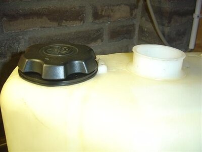

I just wanted to repost these from PWCT. I'm about to do this tonight and these really helped me decide to do it. I think this was freestylegeeks setup.

I did it... it works great
DO NOT USE SILICONE TO SEAL IT....

You should try it the way I did mine. In my opinion it is the best way to do it, your able to use both straps and it looks super clean. If you want some more pictures of my set-up just ask and I can send them to you tonight.

Here is another way of doing the mod, and this way both straps will work.
We call it the Essefel mod!:biggrin:

Post some pics if you can. I would like to keep both straps.

Alright so I'm ready.
Should I just go with the stock rubber seal and the stock screws right into the gastank.

mine uses the stock seal and screws.. stays airtight. It always releases vacuum when I loosen the cap. I did this mod a year ago and it still seals GREAT.
just drill your pilot holes for the screws SMALL...
