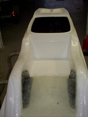

Totally unbiased, but something doesn't look right with that foothold install. And not knocking on Steve, but I wouldn't have installed those paper thin footholds to begin with. What did you think was going to happen? No offense of course.
And at least they cracked and stayed installed, instead of completely ripping out, hydroturf and all :wall: :laugh2:
Well then, what is wrong with the install??? Darin was one of the first guys over at PWCToday to install footholds, throw on a lowered freestyle hood. He has been installing footholds longer than most of the guys here. He knows how to properly install footholds. Trust me, there is nothing wrong with his installation.

What's funny is if I was trying to hide anything I did wrong, I sure as hell wouldn't have posted pics of it.
The footholds have black spray paint on the back, and the 3M I used all the way around them to glue them in and the foam inside the hull never bonded to them because of the paint. My fiberglass was the only thing holding them in because of the paint. Once I cut the biax, the hold just pulled right off like I was making a mold of it with the foam.
And yet I messed up apparently.

After looking at the install pics, they looks glassed in very well to me. It is hard to tell how they were glassed in in the pics posted in here so far. Hence me saying something doesn't look right instead of just calling it out.

Back in post #80 I posted a pic of everything glassed up and ready to foam. http://www.x-h2o.com/showpost.php?p=96727&postcount=80
Being the first guy to install footholds or reading more posts about installing footholds doesn't mean your doing it right or an authority on the subject.
BTW BK, my footholds are the same thickness as wammers.
I weight 230lbs , can plate to plate a roll and my footholds in Whitney are still as strong as the day I installed them almost 5 years ago.
attachment.php
there you go! the bi-axial is on on the edge of the foothold where it still has support from the pump cavity. You need it to go inside the hold all the way to the back inside of the holds, that is where their is no support underneath (except maybe some foam maybe)

Darin when did you purchase these footholds? New when purchased?
Steve have there been any design changes over time with the footholds?
Have they always been painted? I recall mine being black but I thought it was dye in the resin.
Doug
Beginning of this thread, August 2006.
Nice try Steve.
Even if I had done that, it would have broken the way it did.
His are thin, but I dont remember any of his falling apart. Do we need to install 2x4's up under them??? I always thought the foam up under the holds supported them......
