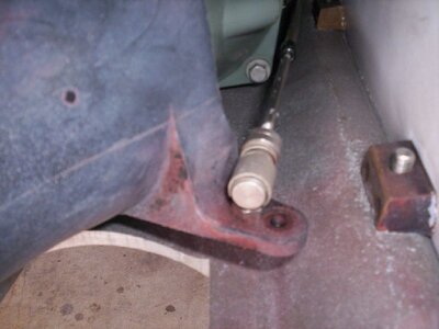

Here is what I set up... I noticed I get noticably more throw to the left than I do to the right... Is this normal for all quick steering setups?
I ground both back sides of the steering nozzle so it would not hit the reduction nozzle.
I ground the bottom right pump bolt flange a little because the steering cable was hitting it, so now it does not hit when the nozzle is pointed all the way to the right.

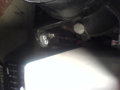

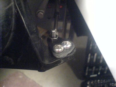

I am not sure if this little bracket is better than just drilling a hole closer to the nozzle like the next pic.... I would like to hear your opinions.
