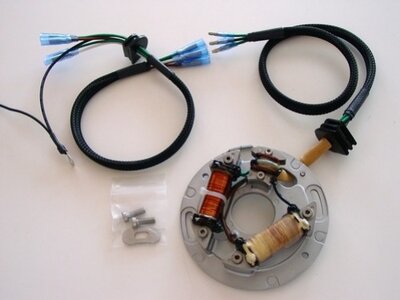

JSS sends his back with optional waterproof bullet connectors, nothing fancy and proven to function well in salt environments.
Personally I don't bother. I don't pull mine often enough to risk another corrosion point.

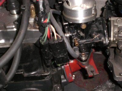

What about the GM weather pack connectors? How do those hold up in the salt?

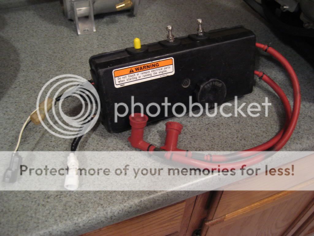

Bingo.. Thats what I use. Watertight, with die electric grease. They are the shiz. I love being able to pull the ebox. I use the JSS solenoid terminal relocators also, so two nuts, two plugs, and sparg plugs and I can pull the ebox right out. I haven't had any issues with corrosion in over a year with this setup, maybe 10% of that was salt. I've had connectors corrode in fresh water though, and these are still golden.

I used the weatherpack connectors and they worked great.
weather pack does not equal water proof.
any electrical connection that is exposed to salt water will fail. I've soldered, heat shrunk, and ruberized connections (all 3 at the same time) that still ended up failing. The best bet is not to cut you wires.
