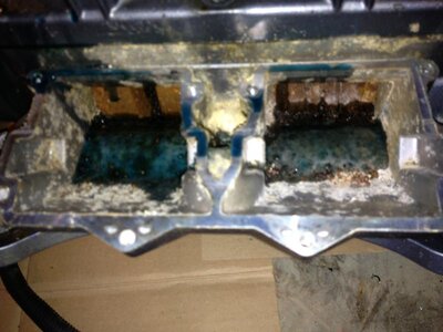

Came out of a really clean VXR pro. Was hopeing it was in good shape, but turns out its seized. Looks like it took on water and was not cleared out. Still not sure how it took on the water. Head gasket looks ok, and the ski doesnt look like it sunk.

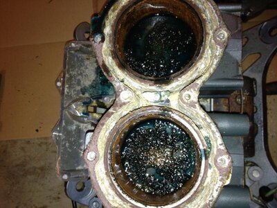

Anyways I want to rebuild this engine for my SN maybe. Im attempting to remove the cylinders right now and they wont budge. Any tricks to this? I have penetrating fluid and 2 stroke oil soaking right now.
Also I notice at the bottom of they cylinder there appears to be pry points. Im always real worried to mess up the base gasket surfaces doing this, I dont like shoving a screwdriver in there, but I guess thats how its done. right?

I had one like that before. I just tossed it because closer inspection found a cracked water jacket and case. Corrosion is one thing but if it ever froze with water in it, that's a game changer.
I know it's harsh but did you try beating the pistons down one at a time? If you do this with the cylinder still bolted on you can some time get the pistons the free up some with out hurting the gasket surfaces. The piston s rods crank and bore is already junk. Best you can do is possibly save cylinder (gonna have to be bore or maybe re sleeve) and cases.
Ill give banging the pistons with a peice of wood a try. I just wanted to try and save the cases and cylinder. Use the crank for a core if I can. I have no idea if it froze, ski sat for a year like that, so its possible. Im just wondering how it got water in the engine. I guess if I get the parts off I will have to clean up nice and look for cracks.

We built a special tool to take apart stuck motors that we use in the shop, but you can try lots of heat/cool/penetrant cycling to try to break free. Wood is a waste of time (to soft), need to hit it with metal bar to jar it.

dont beat the pistons down all you do is wreck the cylinder. remove the bottom case and cut the rods off remove the cylinder and hit the pistons out the top of the cylinder. soaking a motor like that is a waist of time. air hammer on the wrist pin will shoot the pistons right out. if you you have ben beating the pistons down the cylinders are most likey cracked.
thats a 20 min tear down you have there.
