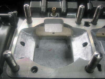

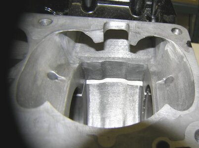

View attachment 232101View attachment 232099View attachment 232100
few case pics - Filling is for the voids in older Kawasaki cases and Yamaha cases. SXR's only need reed stuffing area filling depending on what cages. Some older small pin cases were also solid like the SXR cases.
