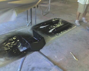

Painting the Handlepole, bracket, and sponsons.
Black with a dip of silver to add a awesome metallic sheen, and finishing with clear coat.
