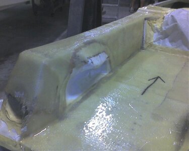

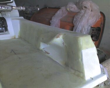

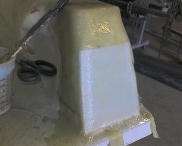

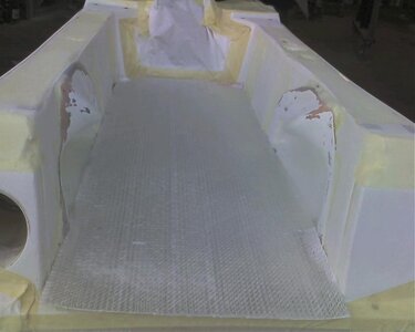

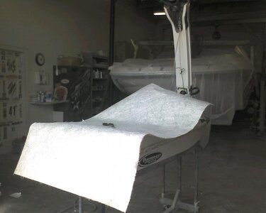

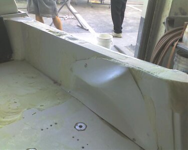

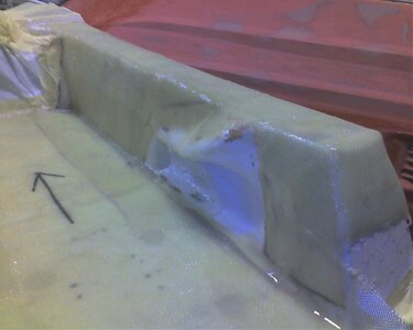

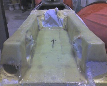

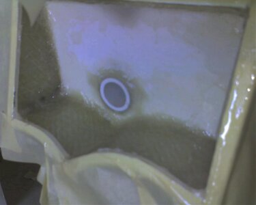

Hey everyone I made it back into the shop for a half a day after one of my practices last week before my tournament.
I started by sanding and shaping all the foam around the sides that came out alot better than I thought.
We got the big sheet of glass, I cant remember which specific one it was but it was very tough and one of the strongest sheets he had. It was woven on one side with glass fibers on the other side woven into it.
With the help of my friend John again he did the finish work with his sander wheel and got everything shaped perfectly and preped for glassing.
Im doing a whole new layer of glass for my tray to replace the hole i made in half of it and to provide strength for the years of stress it will take.
He measured up and cut the sides of the footwell sheets.
Mixed the resin and got to work.
We also laid down some thinner cloth to wrap the corners cleanly and keep them intact.
And that was that, It is now dry and sitting in the shop still, I hope to get back in there this Saturday to begin sanding and smoothing it out for the finish work. I'm stoaked riding season is coming a little quicker than I thought.
Thats it for now
Still more work to be done.
Thanks
-Mark

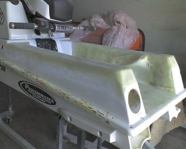

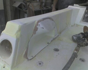

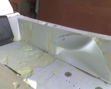

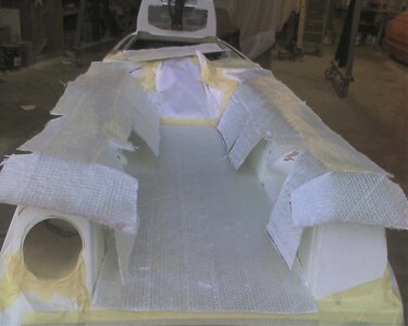

Update
Just got back from the shop a while ago,
Turns out that John shaved down the fiberglass laid from the last update the day after before it became bullet proof. It looks great so far! :Banane09:
There were some spots that need a little more cloth to be laid down.
So i started by cutting some cloth to Strengthen the S^#T out of the rear hull extension where my versiplug will be.
We mixed the epoxy resin and got to work laying down the cloth.
Then he helped me mix some filler to help me puddy up some holes in the bottom of my hull from screw holes or my first attempts long ago to drain my ski.
Not a whole lot happened today but its definetly progress. I cant to much more the glass has to set.
Next day i plan to be back in is either the 25th or 26th maybe both if I'm lucky.
Until the next time
-Mark
