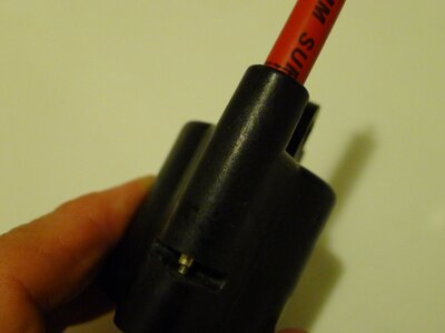

Some time ago- when I rode a lot-, I would get 2 years, maybe 3 at the most, out of the coil wires on Kawis or Superjets. Rebuilding my coils with a (more) flexible core put a stop to that problem. One of my skis has such a coil that has been used for over 20 years on diff. skis, just replaced the MSD boots as they "tired". I also found out that oem couch coils with the flexible core seemingly last forever. (pic)The spiral core wires are used on oem coils on most/all couches with 701 and up, probably to help prevent interference problems with the gauges.
