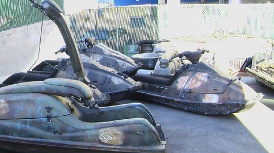

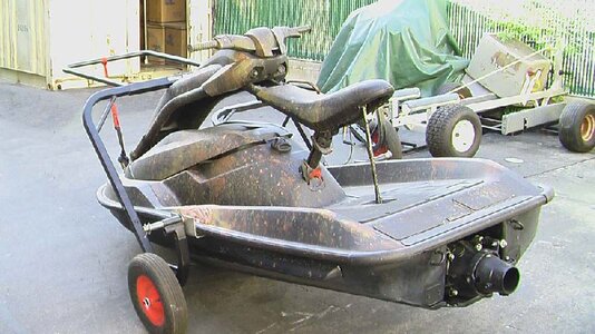

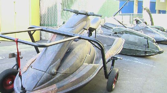

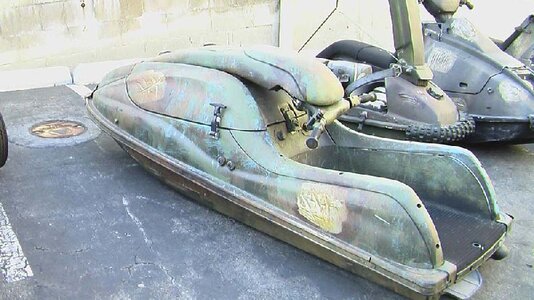

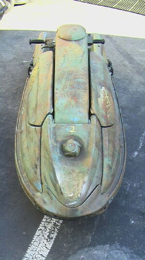

After over 10 years of 550's, universal upgraded them to new SXR's. Also it looks like they are going to replace the Kawi SS with a seapoo 3d. But they're keeping the old X2's cuz they said it would cost too much $$ to widen the catapult for the jetski/waterskier launch.
The SXR's kinda suck. The second we sub them they starve for air and die really quickly if they go too deep. I've spent a lot of time in the last couple weeks working with the mechanics to get them show worthy. The 550's were freakin submarines. Also the SXR's don't spray nearly as good. You have to spray super flat or else the ski just goes into a turn. With the 550's you could spray almost vertical.
One ski sunk when we were training on them and it bent a rod. The bottom of one of the hulls is trashed from hitting the ramps. Hopefully we get these kinks worked out, cuz I'm really starting to miss the 550's.
