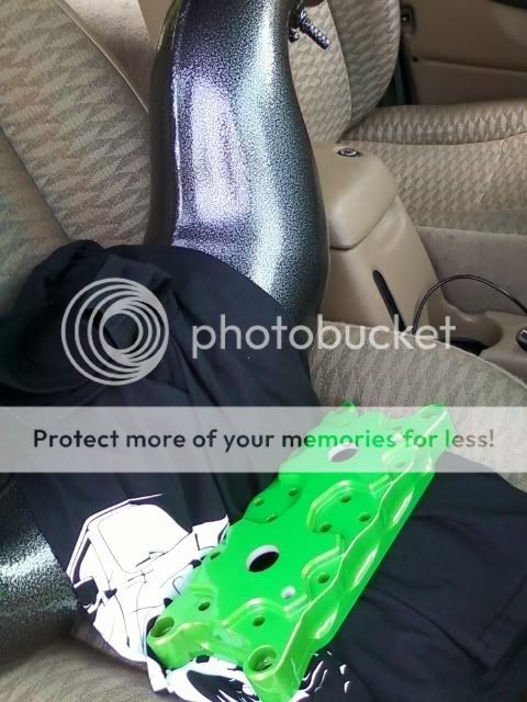

With the dry pipe, the 28CC domes and the porting i had to up-grade my jets, so i took out the 80 low speeds that my wet pipe came with and added some 85 lows. I'm about 3/4 of the way out on the lows and the hit is awesome. I also have somne stiffer pop off springs to go in but i was waitiung for them to come in at my local shop.
I'm thinking i also need to re-upgrade my impeller for the added power, i seem to be spinning out my 10/18 large hub swril, i might look at a hooker prop or see about trading mine in for a deeper pitch, not looking for crazy top end just low end grunt.
Im pleased with the way my ski is fianlly running, next i'd like to finally get my new hand pole and a lightweight flywheel. I'll take some pictures of the ski out on the water and get them up when i can.
