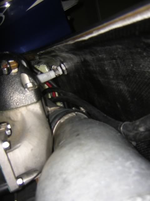

i had the flow control valve setup wrong, it was after the T to the pisser/waterbox. put it in before the T and it works perfectly. brap off the bottom is way better!

Wow, I thought the flow valve was suppose to be after the t, not before.
What valve did you get? Pro?
Did you change the adjustment?
Just wondering b/c I just purchased one to install when I get done with my build.

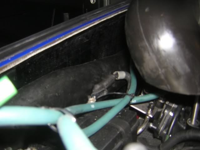

well this is how it was
http://www.x-h2o.com/photoplog/images/1958/1_DSCN2468.jpg
i figure there wasnt enough water pressure to open it and all the water just went straight out the pisser, path of least resistance. now its before the t i can see that its turning the flow on and off.
i got the regular one to try, its still ajustable, the ease of external ajustment isnt worth the extra 20$ to me. according to the directions it comes setup for stock/lightly modified motor, so i just ran it.
