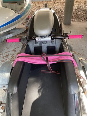

Removed the bulk of the stock graphics that had seen better days, bought new zero degree handlebars, a Cold Fusion throttle lever, and grips. Not too much previous mechanical experience, so a friend assisted with the throttle lever install when I got stuck trying to disconnect my throttle cable. Already was living for these learning experiences and newfound knowledge.

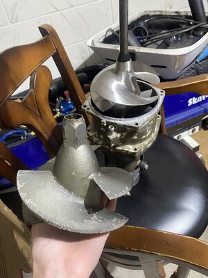

Wanted it to have more power my first week riding it. Three weeks after buying it, I got lucky and was able to order a new limited b pipe for it. Ordered new carbs with adjustable t-screws for tuning, a Hooker 9/15 impeller, and bilge pump kit as well. Paid a friend to help teach me how to put the pipe in the ski properly when I was worried about accidentally cutting corners doing it myself. @augustaf later joined myself and @callmefinch and lent his tools and expertise on the impeller, pipe, and bilge pump.

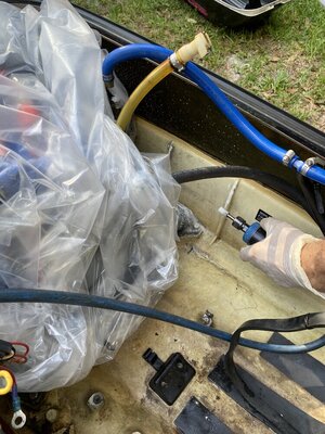

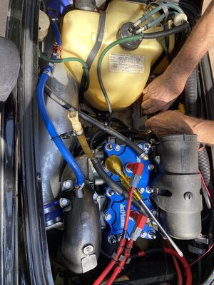

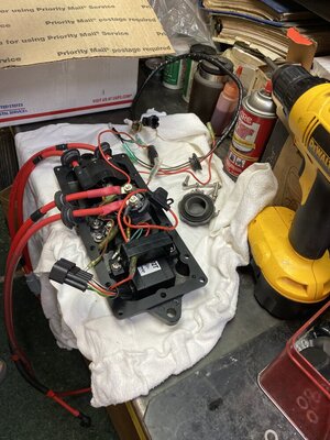

Was informed on the importance of having a girdled head in conjunction with the aftermarket pipe. Ordered a girdled head kit in the middle of the pipe install, as well as a Worx 201 intake grate. I switched out the stock intake grate for the new one. Set out to install the girdled head kit two months after the pipe install with help from Fred @augustaf and opted to buy one of his very own well-made Zeeltronics 760 ebox kit setups with a lightened flywheel to install at the same time. Went with the charging system rather than total loss as a personal preference with this ski.
Reached a happy place with it! Added red plastic retainers to the spark plug boots. Water test and tuning, all was sound and well. Bought an extended ride plate to experiment and try out. I keep it in case I ever want to play with it again, but have kept the ride plate stock thus far. Ordered a flow control valve. Thanks to @JetManiac for quickly shipping parts for this build and providing knowledgeable advice along the way.

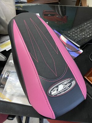

Had Jettrim make a new chin pad cover for me that I had a local marine upholster who also installed my SC seat cover and did some maintenance work on the foam attach since I was unable to stretch it enough on my own.

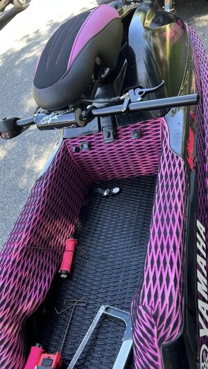

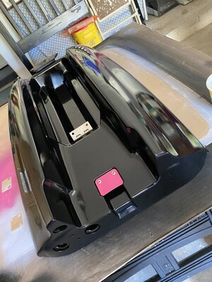

Wanted footholds, but didn’t feel confident to attempt them myself on my prized possession. Ordered Wamilton footholds, Hydro-Turf sheets, padding, and took my ski south to @waterfreak to have him do turf and footholds for me with a color scheme idea I had. While my ski was down there, I removed the peeling vinyl wrap that covered my hood and paint it with automotive spray paint and primer. Didn’t turn out too bad, but has chipped quite a bit since.

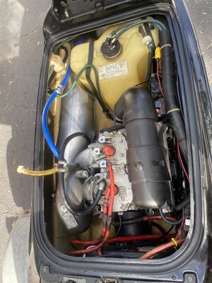

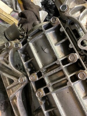

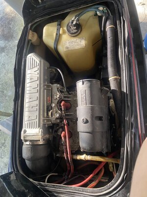

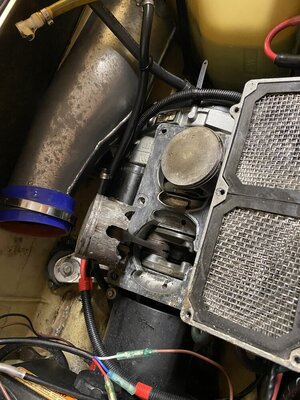

This was about the time, a month and a half after completing the last major mechanical upgrades, that we realized my ski engine had bit the dust after it’s last ride. @augustaf invite me over to diagnose the problem and find a solution. While taking it apart, we identified the culprit.
18E0B1FC-BFA5-4EFF-8B3B-7BA13B94DA6D.jpeg995A2F30-913F-45C2-935B-19638FE5A8B5.jpegFFFB48BE-FBAE-400F-9334-7C867DE811D1.jpeg

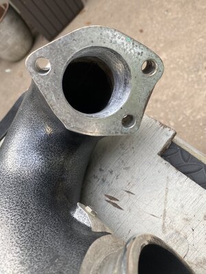

Piston broke and shot down metal through the crank and broke the crankcase. Noticed while we were taking the ski apart that, though unrelated, my pipe chamber was rubbing on the engine and leaving quite the dent. Him and I immediately set out to rebuilding my ski together. Attempted honing on the cylinders first before opting to bore a size up. New SBT crankshaft, bored cylinders and a welded crankcase repair done by @Blue, new pistons, etc. Along the way, Fred had some choice ideas for upgrades to my SJ. He bored out the b pipe to 49mm, we replaced the stock reeds with fiberglass ones, drilled and set up the inside in a y-off for a modified version of dual cooling, and the engine came back together perfectly and better than ever had been prior.
Water test and all was excellent. I still struggle with the art of tuning skis though.

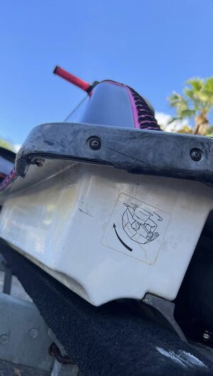

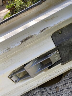

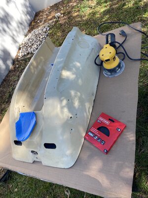

@augustaf and I later worked on doing some repairs to the bottom and lower deck sides of my ski after it ran away while I attempted to load it on the trailer one day and got some new surface scratches. It had always looked less than stellar since purchase underneath, but never posed any noticeable problems. We used marine epoxy. Tuning adjustments seem to have resolved the running away on the trailer issue it had briefly.

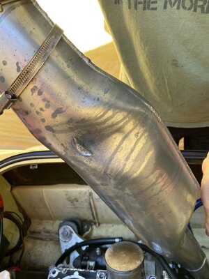

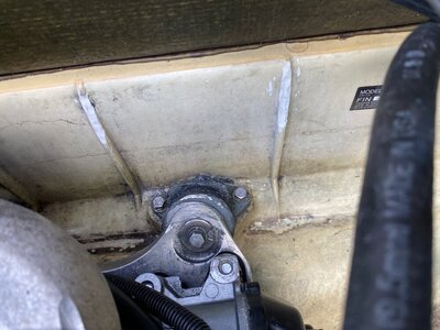

We later addressed the pipe rubbing situation, which was creeping up again. We ground off the corner of the engine’s bed plate, citing a photo Blue provided me for reference, and partially ground down the sidewall ridges enough to give it clearance.

Newer updates: A friend helped me out in December with some repairs to my rails and nose, and turfing the rails in the process. Hoping to eventually be able to shadow someone on the turfing process to better learn how to do it myself at some point. YouTube videos on the topic don’t give me a well-rounded enough idea to feel confident in trying it on my own yet.

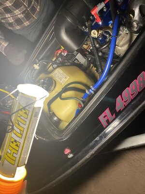

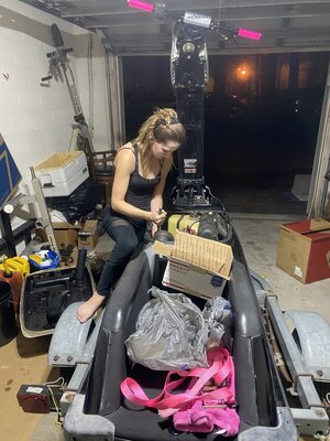

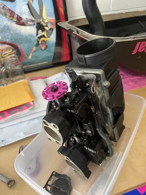

Following a persistent issue with it randomly still running away on the trailer after riding, the same friend rebuilt my carbs for me this past week. Multiple failure points, so hoping this might resolve the issue. Installed them and switched out to the pink throttle wheel I’ve had for awhile.
edc95640-6ab4-4228-82ad-1657bba149f8-jpeg.422540
Still need to tune now that they’re on!

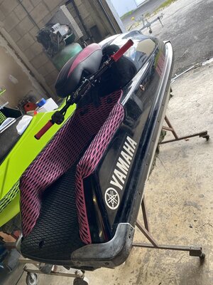

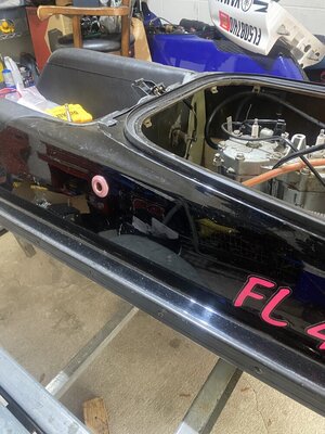

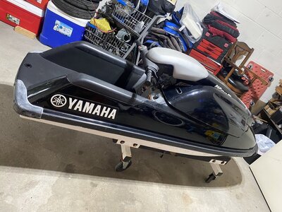

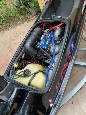

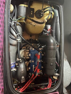

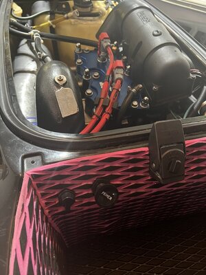

As mentioned in the previous comment, did give this ski a lot of overdue attention when I brought it to my friend for tuning a few months ago. Ended up with shorter handlebars, true dual cooling, a primer, drilled waterbox, some carb adjustments, and sawed down corners to prevent the regular backsplash. 1FD146C1-61CC-4053-A90C-276EFB5DF2ED.jpeg8C1117F6-F28D-4A92-8372-033F42FCE580.jpegEB72AE40-D1F0-4306-A671-E9957E18F6C6.jpegCAF36B7F-6B56-4721-B338-C730B356D1D3.jpeg

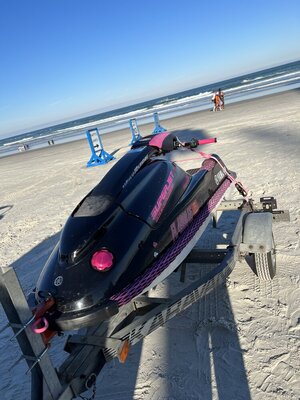

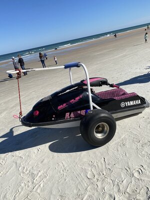

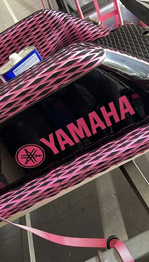

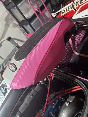

Some of my own cosmetic updates as well. Pulled the remaining OEM graphics in favor of some hot pink details, JetTrim made me a new chin pad cover with more pink on it, and put together a matching scissor stand.
Really loving it! Always getting better.
