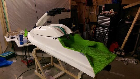

U can do the padding and turf in a single day if ur organized. Make ur templates approximate with plenty of overage and then u can trim it precise. It does suck compared to turning a wrench since turf is so inexact, but just go at it with a chill mindset. Seriously not that hard if u have a heat gun or hair dryer and plenty of sharp knife blades. The ski is too good looking to ghetto up the turf. Nice job from start to finish amigo!Won't be doing the rails this year. And I'm gonna do a super quick ghetto job on the rest for now lol. Not lime there's much riding left. I'll strip it down again and paint and turf this winter.
