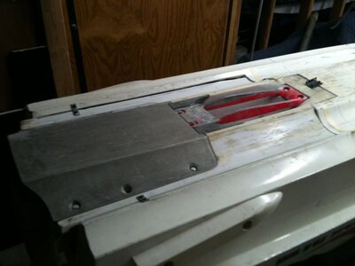

Did more cutting today and finally got the pump section to fit somewhat flush with the hull. I put a couple brackets on it just to hold it in place for now to be able to take a step back and see how it looks. I think I will shorten the pump section to just before the bolts for the nozzle. I have more trimming to do and I am going to cut out the top of the tray so I have access to glass in the pump section.
The rear of the pump section is going to stick up above the tray when it is glassed in so i will have to figure out something to do about that later.
It's coming along... slowly...

Here's an Idea. Glass will vibrate loose. Have you messed with polyurethane adhesive? I've used a ton lately. It's amazingly strong and used for skis all the time. I noticed that not only is it used everywhere but the FX-1 came from the factory with mounts from another ski glued into the hull with PU. No glas just poly. Those mounts are solid. See my pics of one of my FX-1s inside and you'll see what I mean. Ive been using the slow cure stuff from Home Depo. Its cheap and very good. You can get "Better" stuff from boat shops or US composites.
The best part is, you have the piece you need from the cut up SN.
See, Yamaha used poly everywhere on this hull. So take your hull fittings from the trashed hull, mount em up, align them, support the engine in place and glue away. The trick is the slow cure stuff holds better but has to cure for a loooong time,
I don't mean to hi jack your thread but if i were to use the poly adhesive could i just grind down my 300 mounts clean carefully remove my 650 mounts and glue them into to the 300 hull? If this is the case what is the brand name of the glue?
Melmack
(Timothy)
You cant just glue in the mounts alone. You need a large surface area to bond securely. I would say the area used for the fx-1 mounts pictured above would be a minimal amount. You could mount the mounts to an aluminum or SS base if you don't have a chopped up hull to steal from. Then glue the large aluminum or steel base to the hull.
The adhesive Ive been using for gluing wood to wood, auto glass to plastic, brick to mortar with good success is Loctite PL Premium. Don't use the Advanced version as the quick cure time probably kills the bond strength.
You should try this stuff yourself before taking my advice. I haven't bonded a motor with it yet but I'm convinced this is the same stuff that the manufacturers use. Just much cheaper because it doesn't say 'Marine' on it. Kinda like marine silicone. How much more than 100% silicone can you get?
I did a test with a dirty piece of 2X6 to the inside of a butchered wave venture. I didn't even bother to clean both surfaces. After 24hours, it was almost impossible to remove. It wouldn't pry off. I finally got it off by hitting the back side with a log splitter sledge very hard. It took a huge impact to remove it.
