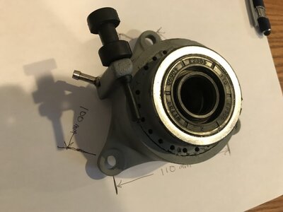

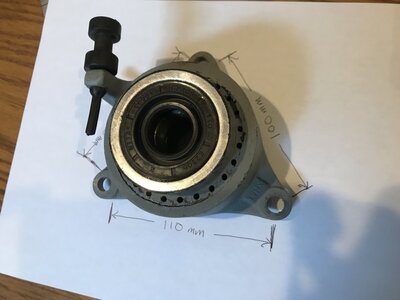

Can you experts tell me if this is a small housing that will fit on my 91 Superjet. I bought this as a spare which the seller claims it is for the 90-93 SN Superjet, but mine does not have a grease fitting. measurements between bolt holes center to center, bottoms are 110mm, bottom to top are 100mm. thanks in advance.
Yes, that is the smaller size housing for a 650. It is an a/m housing made by Lynx.
