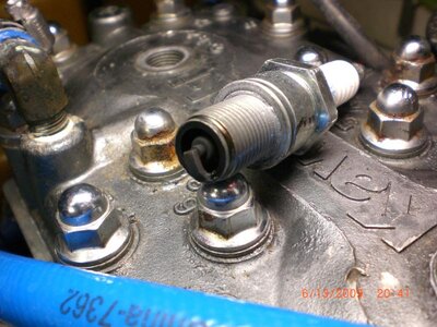

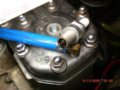

What's your plugs look like?
Here are plug pics. Rear plug was a little wet. Front cylinder was dry.

Dual carbs?
The first plug looks a little lean to me.
U could try richening the mixture 1/8th turn on the low and high and see if that helps.
